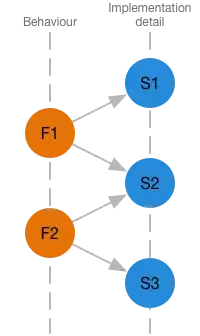

In graphical form
Where do you drop the tests?
- Testing F1 and F2 only will yield redundant tests for S2.
- Testing for S1, S2, and S3 will not test for the behaviour of F1 and F2.
