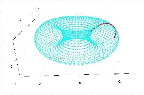

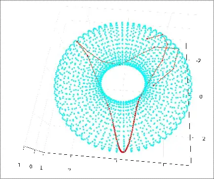

The question about how this relates to complex-number calculations really gets at the heart of why both +0 and -0 exist in floating-point. If you study Complex Analysis at all, you rapidly discover that continuous functions from Complex to Complex usually cannot be treated as 'single-valued' unless one adopts the 'polite fiction' that the outputs form what is known as a 'Riemann surface'. For example, the complex logarithm assigns each input infinitely many outputs; when you 'connect them up' to form a continuous output, you end up with all of the real-parts forming an 'infinite corkscrew' surface around the origin. A continuous curve that crosses the real axis 'downward from the positive-imaginary side' and another curve that 'wraps around the pole' and crosses the real axis 'upward from the negative-imaginary side' will take different values on the real axis because they pass over different 'sheets' of the Riemann surface.
Now apply that to a numerical program that calculates using complex floating-point. The action taken after a given calculation may be very different depending on which 'sheet' the program is currently 'on', and the sign of the last calculated result probably tells you which 'sheet'. Now suppose that result was zero? Remember, here 'zero' really means 'too small to represent correctly'. But if the calculation could arrange to -preserve the sign- (i.e remember which 'sheet') when the result is zero, then the code can check the sign and perform the right action even in this situation.
