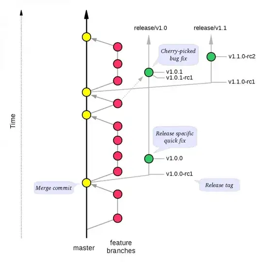

I’ve been looking at “A stable mainline branching model for Git” which I think has the potential to solve this problem nicely.
To summarize:
  • Single branch for development (master). Features branch from master and are merged back to master
  • When master is stable and ready for a release, branch off to e.g. release/1.0 and tag the commit as a release candidate
  • QA the release branch
  • Make updates and new release candidates as necessary on the release/1.0 branch
  • Eventually tag v1.0.0
  • Never merge release branches back into master
  • Meanwhile, feature development has not stopped on master for the next release
  • Hotfixes are ideally made on master and cherry-picked to release branches. If that’s impossible, hotfixes can be made on the release branch itself and a ticket should be made to fix the problem properly in master.
visual depiction of branching model as described
The article has a lot more detail about different scenarios with this model and how to solve them.
