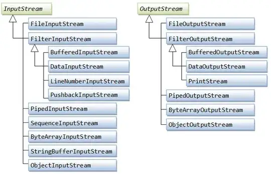

Why are streams abstract base classes instead of interfaces?
- It is possible to define a strictly minimal interface.
- Typically this consists of: read, write, seek, tell (returns current file position), get length, truncate (reduce file size), close.
- However, to make the stream implementation convenient to use, a lot of helper methods on the class would be needed.
- Without these helper methods, it would make the programming language impractical, because it would then be too troublesome to use streams as a fundamental feature of the standard library.
- These helper methods make use of the minimal interface.
- Typically, default (standard) implementations can be provided for these helper methods, that would completely satisfy the needs most of the time.
- Therefore, abstract base classes are used to provide these default helper method implementations to improve the usability of the standard library.
