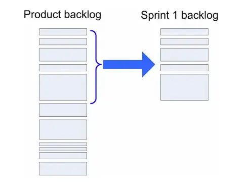

In an agile team, who is responsible for making high-level architecture and design decisions that affect the entire system, not just the work being done in the current sprint?
Maybe product owner, scrum master, the scrum team or someone else?
