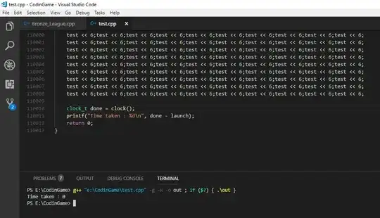

So, which one will be faster? I think it is a good approach you chose to actually test out the performance difference. In general, it is easy to be surprised by the runtime performance of some code changes. There are many techniques modern processors employ and the interaction between software can be complex, too. Even if you should get beneficial performance results for a certain change in one situation, I think it is dangerous to conclude that this type of change will always yield performance benefits. I think it is dangerous to run such tests once, say "Okay, now I know which one's faster!" and then indiscriminately apply that same optimization to production code without repeating your measurements.

Yes, in most real-life scenarios, and almost certainly in JavaScript, attempting to exploit this equivalence for performance's sake is probably a futile undertaking. However, even if we forced the use of multiplication instructions and then saw no difference in run-time, that is more due to the nature of the cost metric we used, to be precise, and not because there is no cost difference. End-to-end runtime is one metric and if it is the only one we care about, all is well. But that does not mean that all cost differences between multiplication and shifting have simply disappeared. And I think it is certainly not a good idea to convey that idea to a questioner, by implication or otherwise, who is obviously just starting to get an idea of the factors involved in the run-time and cost of modern code. Engineering is always about trade-offs. Inquiry into and explanation as to what tradeoffs modern processors have made to exhibit the execution time that we as users end up seeing may yield a more differentiated answer. And I think a more differentiated answer than "this is simply not true anymore" is warranted if we want to see fewer engineers check in micro-optimized code obliterating readability, because it takes a more general understanding of the nature of such "optimizations" to spot its various, diverse incarnations than simply referring to some specific instances as out of date.
gcc -S, the code fortest *= 2is actually compiled toshll $1, %eaxWhen invoked withgcc -O3 -Sthere's not even a loop. The two clock calls are a line apart:callq _clockmovq %rax, %rbxcallq _clock– Jul 21 '14 at 21:00mulnorlshlwould be the most efficient instructions on modern x86 for a multiplication times 2 the last time I checked. Turns outaddis the best to pick! I'd say chances are good that a mediocre compiler would go to the extra length of changing multiplications by 2, but may miss out shifts by 1 - probably not, but that's one way I can see how this "optimization" may actually backfire. – Voo Jul 22 '14 at 23:04
