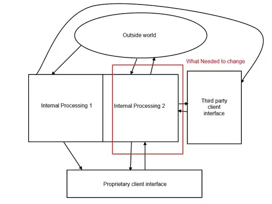

Here's the challenging part: the code that needed to change was the GLUE within the system. Here's a very simple picture that summarizes the problem:
This is the situation I was in that led to this question: What should I do when I've already waited too long between commits?
As you can see, it's not only the parts of the code that were doing the internal processing, but also the parts that were communicating with the other parts of the system. Both the APIs and the internal data structures were insufficient. Attempting to keep both sets of APIs working for incremental changes would have been woefully redundant.
