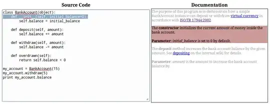

Why do we still embed natural language descriptions of source code (i.e., the reason why a line of code was written) within the source code, rather than as a separate document?
Given the expansive real-estate afforded to modern development environments (high-resolution monitors, dual-monitors, etc.), an IDE could provide semi-lock-step panels wherein source code is visually separated from -- but intrinsically linked to -- its corresponding comments. For example, developers could write source code comments in a hyper-linked markup language (linking to additional software requirements), which would simultaneously prevent documentation from cluttering the source code.
What shortcomings would inhibit such a software development mechanism?
A mock-up to help clarify the question:
Dual Editor Mockup
When the cursor is at a particular line in the source code (shown with a blue background, above), the documentation that corresponds to the line at the cursor is highlighted (i.e., distinguished from the other details). As noted in the question, the documentation would stay in lock-step with the source code as the cursor jumps through the source code. A hot-key could switch between "documentation mode" and "development mode".
Potential advantages include:
  • More source code and more documentation on the screen(s) at once
  • Ability to edit documentation independently of source code (regardless of language?)
  • Write documentation and source code in parallel without merge conflicts
  • Real-time hyperlinked documentation with superior text formatting
  • Quasi-real-time machine translation into different natural languages
  • Every line of code can be clearly linked to a task, business requirement, etc.
  • Documentation could automatically timestamp when each line of code was written (metrics)
  • Dynamic inclusion of architecture diagrams, images to explain relations, etc.
  • Single-source documentation (e.g., tag code snippets for user manual inclusion).
Note:
  • The documentation window can be collapsed
  • Workflow for viewing or comparing source files would not be affected
  • How the implementation happens is a detail; the documentation could be:
    • kept at the end of the source file;
    • split into two files by convention (filename.c, filename.c.doc); or
    • fully database-driven
  • By hyperlinked documentation, I mean linking to external sources (such as StackOverflow or Wikipedia) and internal documents (i.e., a wiki on a subdomain that could cross-reference business requirements documentation) and other source files (similar to JavaDocs).
Related thread: What's with the aversion to documentation in the industry?
  • What advantages do you see in this approach? – Uooo Sep 19 '13 at 05:21
  • I think that separating code and docs is a good thing, because it helps to make sense of the documentation even without all the nasty implementation details. But I think you are just supposing a special view on a single source file, not separating source and doc. – SpaceTrucker Sep 26 '13 at 09:56
  • How is this different than what Eclipse gives you already? http://i.stack.imgur.com/HEQ8w.jpg (code, pagage outline, and bottom panel javadoc of what the cursor is at) –  Sep 26 '13 at 18:08
  • The "inflate the menu" comment is interwoven with the code. That's how it is different. – Dave Jarvis Sep 26 '13 at 18:09
  • Also, the documentation for Gson describes the Gson API, which is great, but does not answer why the Gson() object is being instantiated in relation to the MainActivity class, nor how it relates to solving a particular business requirement. Describing the code itself, rather than the APIs it uses, could be in a separate window, independently from third-party JavaDocs. – Dave Jarvis Sep 26 '13 at 18:18

Possible disadvantages that I see:
  • You need a special editor that implements this feature
  • The code is not just plain text anymore, easy to manipulate and commit to VCS-es
  • You need twice more screen width to work with the code
As for your arguments:
But can be inconvenient if you want to view two files side-by-side.
I would argue that it is actually a disadvantage. I personally try to keep the documentation as close as possible to the code, so that it does not become outdated.
Again, possibly a disadvantage. If your docs are deeply interleaved with code, how can you edit them independently?
If it is in the code, it is already real-time ;) As for the hyperlinks, jumping to definition is already implemented in most IDEs.
I don't see why you can't do that with regular comments/docstrings.
This I'm uncertain about... Can't it be achieved with regular comments?
Don't VCS-es provide this kind of information already?
Having said this, I quite like the layout itself — but I do not see the need of changing the file format, it is not that difficult to generate it from regular comments. There's a bunch of documentation generators which do that, e.g. Docco and its successors, like Pycco or Marginalia.
fjarri
  • 436
  • VCS-es track an atomic commit (each line receives the same timestamp). I'm suggesting that you could track the date and time of each line of code independently, allowing for a video to be made, for example, of how the software was constructed over time. This would open the door to analyzing the thought processes of developers in greater detail than what is possible with atomic commits of many lines of code. – Dave Jarvis Sep 19 '13 at 16:19
  • I see. But wouldn't you want to collect such statistics about the documentation as well? This should be some completely separate facility. Also, I think I've heard about this idea, but in the context of writers — something about giving future scholars the ability to track the author's thought process by watching how he typed and discarded pieces of the text. – fjarri Sep 19 '13 at 23:34

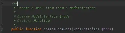

  • Most IDEs support collapsing code/comments, with the end results being the following: enter image description here
    Instead of the normal:
Make the code more readable, in case you don't need the comments.
