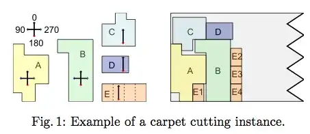

At my previous place of employment, there was a person working on a computer program to optimally cut carpets. Optimal Carpet Cutting shows how this can be done. It involves some math (frankly that is a bit above what I can understand with a glance). And yes, this was being done for a webapp (there is even more fun in that of trying to figure out how to send it from the back end to the client - do you json it up and rerender it? how would you store that? Or maybe just generate an image on the back end?).
An optimal carpet.

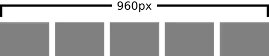

For example, say you have a 960px wide page, and you need to put 5 boxes on it, flush against the sides, with gutters in between:
Diagram showing 5 evenly spaced boxes in a 960px wide area
Lets assume we'd like to try for 20px wide gutters, and hope the math works out. That's leaves us with a bit of algebra:
5x + 4(20) = 960
So solving for X tells us that are boxes are each 176px wide. However, we're working with a responsive fluid grid so pixels won't cut it. We need that as a percentage so we pull out our responsive equation (from the book):
(target/context)*100 = percentage
But wait! It turns out we'll need multiple rows, and so can't just use :first-child or :last-child to cancel out the extra margin. We could use nth-child(5n) (look! Math!), but we want legacy browser support, so we'll wrap the boxes in a container that's 20px wider than the 960px and give it a negative right margin.
  • So the container width is: (980px/960px)*100 = 102.083%
  • And the container's right margin is: (-20px/960px)*100 = 9.375%
  • And the boxes' widths are: (176px/980px)*100 = 17.959%
  • And the boxes' right margins are: (20px/980px)*100 = 2.041%
And then lets assume we want each box to be the same height as 6 lines of text, and that we're using the default font size of 16px, with our line height set to 1.5 (16px*1.5 = 24px), and we're using ems for our vertical units, which are factors of the current font size.
That means the height of one box is (6*24px)/16px = 9em.
And if we want a 20px margin between the rows, the boxes need a bottom margin of 20px/16px = 1.25em
