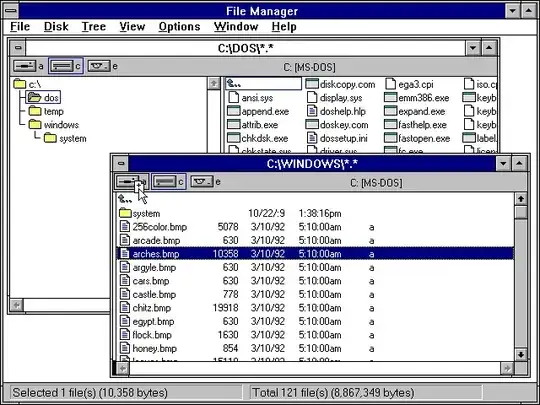

I'm kinda reminded of back when the analogical equivalent of "Windows Explorer" was called "File Manager", like so:
And I actually think "File Manager" in this case is more descriptive than "Windows Explorer" even if there's some better name out there that doesn't involve "Manager". So at the very least please don't get too fancy with your names and start naming things like "ComponentExplorer". "ComponentManager" at least gives me a reasonable idea of what that thing does as someone used to working with ECS engines.
  • Agreed. If a class is used for typical managerial duties (creating ("hiring"), destroying ("firing"), oversight, and "employee"/higherup interface, then the name Manager is appropriate. The class may have design issues, but the name is spot-on. – Justin Time - Reinstate Monica Aug 11 '19 at 16:29
