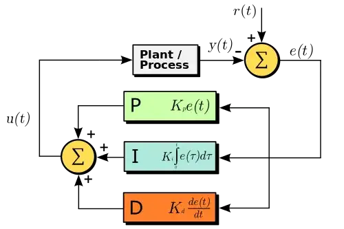

I strongly suggest you use the circuit from this source for studying.
Even though a little tedious to set up, mathematically its much simpler to analyse as you can directly relate it to the standard mathematical form instead of ideal one.

If using Standard form we have,
Assuming the the loop running time is small enough (a slow process), we can use the following function for calculating output,
output = Kp * err + (Ki * int * dt) + (Kd * der /dt);
where
Kp = Proptional Constant.
Ki = Integral Constant.
Kd = Derivative Constant.
err = Expected Output - Actual Output ie. error;
int = int from previous loop + err; ( i.e. integral error )
der = err - err from previous loop; ( i.e. differential error)
dt = execution time of loop.
where initially 'der' and 'int' would be zero. If you use a delay function in code to tune the loop frequency to say 1 KHz then your dt would be 0.001 seconds.
