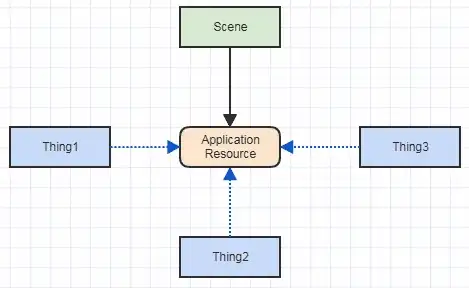

Like logical leaks which are really hard to track down while users just tend to notice that running your software for a long time tends to take more and more memory and get slower and slower until they restart? I don't.
Consider what happens if, when the user requests to remove application resource above, Thing2 fails to properly handle such an event under:
  1. Pointers
  2. Strong References
  3. Weak References
... and under which one of these such a mistake would likely be caught during testing, and which one wouldn't and would fly under the radar like a stealth fighter bug. Shared ownership is, more often than most, a nonsensical idea.
