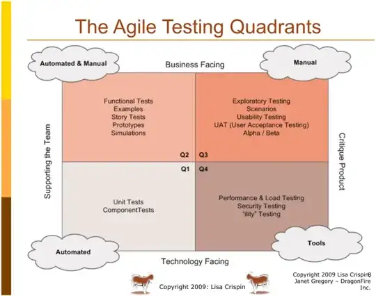

This might help you:
Q1 are written by the developers.
Q2 are automated by the developers and written in collaboration with the business and/or testers.
- 1,113
