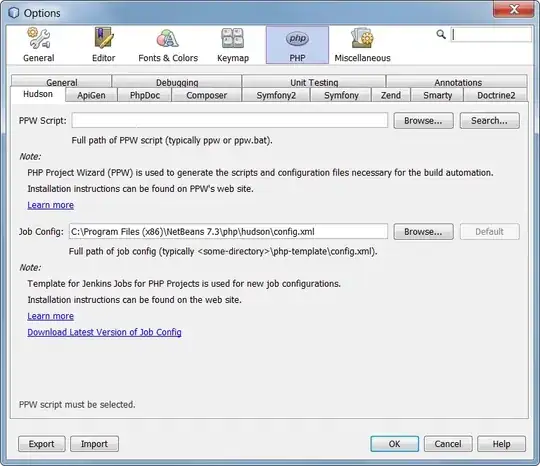

As you commented that you're using PHP - installing Netbeans for PHP might be a good way to go.
  1. It sounds like you've got source control which is the first obvious step
  2. The next obvious step is to make sure Doc Blocks are written for each new function and any function you happen to edit - which Netbeans will help automate
  3. Beyond that Netbeans gives you good instructions on how to integrate all the components you need for CI.
  4. Going from PHPUnit
  5. to PhpDocumentor
  6. through to the Hudson (Jenkins) CI server - they're all bundled in the PHP options for Netbeans.
