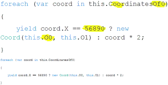

Courier New
Simple to use, but hard to make the difference between the digit "0" and the capital "O". The text is too light, which would make it difficult to read on a black background with light text.

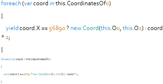

Consolas
The recent Consolas font was specifically created to use in IDEs and other source code-related contexts and to replace the former Courier New. It totally removes the ambiguity between the letter "O" and the digit "0" by using slashed zero character.
It remains very readable for both large and small sizes and for both light text on dark background and dark text on light background contexts. If you use ClearType, Consolas is an excellent choice.

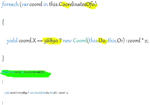

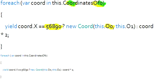

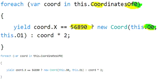

Georgia
This is a nice font, but was rather designed for print. On an LCD screen, small text has some glitches with whitespace which feels not very uniform (as you can see on the screenshot).
The largest issue is that there is nearly no way to make the difference between the small letter "o" and the digit "0". Seriously, is it CoordinatesOfo or CoordinatesOf0? This sole issue is a deal breaker for an IDE.

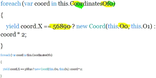

Corbel
The font is very readable, even with a small size text. Due to oldstyle, numbers are very easy to read too.
On the other hand, this font suffers the same issue that Garamond: no clear difference between the small letter "o" and the digit "0". This sole issue is a deal breaker for an IDE.

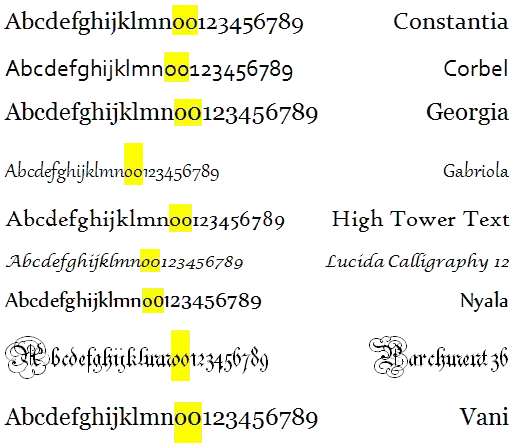

Gabriola
As you can see, the font is impossible to use, unless you set a very large size in your IDE. This font is for happy new year cards, not for programming.
In conclusion, most oldstyle fonts suffer from the similarity between the small letter "o" and the digit "0", and in many cases, there is no way at all to make the difference between the two. See for example Gabriola or High Tower Text: those two characters seem identical.
