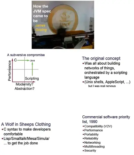

Gosling: a compromise between C and scripting language...
Based on above, I began searching the web for JVM history. Didn't help, too much garbage in results.
Then, I recalled legends about Gosling and narrowed down my search to Gosling JVM history.
Eureka! How The JVM Spec Came To Be
In this keynote from the JVM Languages Summit 2008, James Gosling discusses... Java's creation,... a compromise between C and scripting language...
  • My interpretation:
    explicit declaration that at the moment of creation,
    C and scripting have been considered most important influences.
    Already seen nod to scripting in VM Spec 2.17.1,
    command line arguments sufficiently explain String[] args
    but static and main aren't there yet, need to dig further...
Note while typing this - connecting C, scripting and VM Spec 1.2 with its nothing-of-Java - I feel like something familiar, something... object oriented is slowly passing away. Take my hand and keep movin' Don't slow down we're nearly there now
Keynote slides are available online: 20_Gosling_keynote.pdf, quite convenient for copying key points.
    page 3
    The Prehistory of Java
    * What shaped my thinking
page 9
    NeWS
    * Networked Extensible Window System
    * A window system based on scripting....
      PostScript (!!)
page 16
    A Big (but quiet) Goal:
      How close could I get to a
      "scripting" feel...
page 19
    The original concept
    * Was all about building
      networks of things,
      orchestrated by a scripting
      language
    * (Unix shells, AppleScript, ...)
page 20
    A Wolf in Sheeps Clothing
    * C syntax to make developers
      comfortable
A-ha! Let's look closer at C syntax.
    To be comfortable for C developer, program entry point has to be main.
    Also, since Java requires any method to be in class, Class.main is
    as close as it gets: static invocation, just class name and dot,
    no constructors please - C knows nothing like that.
    This also transitively applies to C#, taking into account
    the idea of easy migration to it from Java.

Based on above I would say that static, main and String[] args were at the moments of Java and C# creation most reasonable choices to define program entry point.
