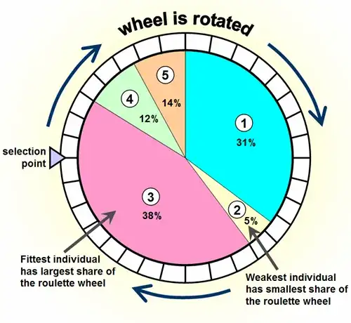

In genetic algorithms this select procedure is called Fitness proportionate selection or Roulette Wheel Selection since:
  • a proportion of the wheel is assigned to each of the possible selections based on their weight value. This can be achieved by dividing the weight of a selection by the total weight of all the selections, thereby normalizing them to 1.
  • then a random selection is made similar to how the roulette wheel is rotated.
Roulette wheel selection
Typical algorithms have O(N) or O(log N) complexity but you can also do O(1) (e.g. Roulette-wheel selection via stochastic acceptance).
