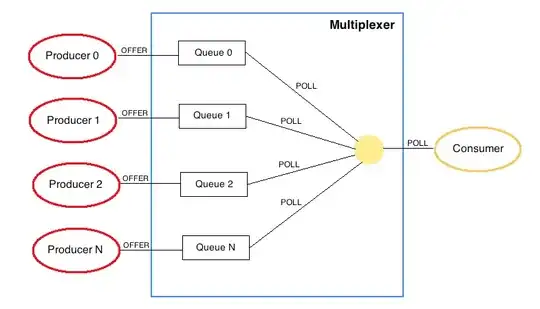

Logging asynchronously is the only way to go if you need low-latency in the logging threads. The way this is done for maximum performance is through the disruptor pattern for lock-free and garbage-free thread communication. Now if you want to allow multiple threads to log concurrently to the same file you must either synchronize the log calls and pay the price in lock contention OR use a lock-free multiplexor. For example, CoralQueue provides a simple multiplexing queue as described below:
You can take a look on CoralLog which uses these strategies for asynchronous logging.
Disclaimer: I am one of the developers of CoralQueue and CoralLog.
