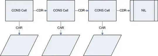

Lisp lists don't really have a 'terminating' value. Actually Lisp does not even have a primitive list data structure. Lists are built out of the empty list and a chain of linked cons cells pointing to list contents.
Lists are recursively defined:
- the empty list is
() - a list
newlistis the result of(CONS element list), where(FIRST newlist)iselementand(REST newlist)islist.
A list is empty when it is the empty list or (NULL list) is true.
Because newlist is the result of (CONS element list) it is actually a cons cell object and `(CONSP newlist) is true.
In older times FIRST was called CAR and REST was CDR. Today it is good style to use in list operations FIRST and REST. CAR and CDR is better used when one exploits the feature that something (tree, queue, list, ...) is built out of cons cells.
Historically (and still in Common Lisp which aims to be backwards compatible), the empty list is also the unique symbol NIL. The empty list evaluates to itself and it is also the false value. In the Lisp-dialect Scheme, the empty list is NOT the false value.

So therefore, is there a philosophical reason why the empty list terminates lists? Yes! The reason is that any object which is understood to terminate a list is, by definition, the empty list. If you use the number 42 as the list terminator, then () means 42.
Mathematically, every list has the empty list as its suffix (just like every set has the empty set as a subset). Since the Lisp list representation is suffix-based (a non-empty list is an reference to an object holding the first element, and the suffix of that list), there has to be something to handle the case when a list has just one element, and its proper suffix is (mathematically) the empty list. Whatever object is installed as the suffix is then understood to be the empty list, and for the sake of consistency and unity, that object better be used as the representation of the stand-alone empty list also, not only as the representation of the empty suffix of the one-element list.

You could think about the language as a set of all facts pertaining to the "world" or "universe" created by that language. As this is a set, you would need to have a complement set for all facts excluded from the language, i.e. something to mean "not in this set". In certain light nil (or false or other variants of "nothingness" may be understood as "not in this set"). Since cons is one of the basic building blocks of the language, the atom that is taken to mean nothingness is used for any not yet created value. So, you don't terminate the list with an empty list (how then do you terminate empty lists?), it's just at some point there is nothing the cons is pointing to and nil is the way to tell that.
