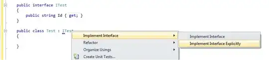

In Visual Studio I can right-click on an interface and choose to Implement Interface, or Implement Interface Explicitly.
Visual Studio Screenshot
public class Test : ITest
    public string Id // Generated by Implement Interface
        get { throw new NotImplementedException(); }
    string ITest.Id // Generated by Implement Interface Explicitly
The only difference I see between the two is that the Interface name is added to the interface properties and methods when they're created if you choose to Implement Interface Explicitly.
I find it makes the code a bit more readable since I can see where that method/property comes from, however does this make any difference in how the class is used or compiled? And does it really matter if I implement my interfaces implicitly or explicitly?

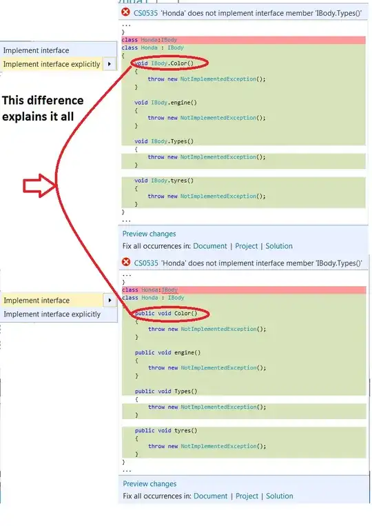

Basically:
  • Implicit: you access the interface methods and properties as if they were part of the class.
  • Explicit: you can only access methods and properties when treating the class as the implemented interface.

There is also a difference in how you call the method.
When using an explicit interface implementation, you must use the interface type in order to call that specific implementation.
So, in calling code you would need to use a variable of type ITest in order to access ITest.Id.

Based on Jalayan's answer,
It allows you to implement two interfaces that define the same method. However, if you explicitly implement the interface, the methods can only be accessed when the variable is typed to that explicit interface.
