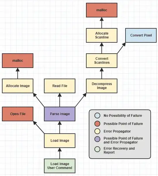

So let's say we have a function to load an image or something like that in response to a user selecting an image file to load, and this is written in C and assembly:
I omitted some low-level functions but we can see that I've identified different categories of functions, color-coded, based on what responsibilities they have with respect to error-handling.
Point of Failure and Recovery
Now it was never hard to write the categories of functions I call the "possible point of failures" (the ones that throw, i.e.) and the "error recovery and report" functions (the ones that catch, i.e.).
Those functions were always trivial to write correctly before exception handling was available since a function that can run into an external failure, like failing to allocate memory, can just return a NULL or 0 or -1 or set a global error code or something to this effect. And error recovery/reporting was always easy since once you worked your way down the call stack to a point where it made sense to recover and report failures, you just take the error code and/or message and report it to the user. And naturally a function at the leaf of this hierarchy which can never, ever fail no matter how it's changed in the future (Convert Pixel) is dead simple to write correctly (at least with respect to error handling).
Error Propagation
However, the tedious functions prone to human error were the error propagators, the ones that didn't directly run into failure but called functions that could fail somewhere deeper in the hierarchy. At that point, Allocate Scanline might have to handle a failure from malloc and then return an error down to Convert Scanlines, then Convert Scanlines would have to check for that error and pass it down to Decompress Image, then Decompress Image->Parse Image, and Parse Image->Load Image, and Load Image to the user-end command where the error is finally reported.
This is where a lot of humans make mistakes since it only takes one error propagator to fail to check for and pass down the error for the entire hierarchy of functions to come toppling down when it comes to properly handling the error.
Further, if error codes are returned by functions, we pretty much lose the ability in, say, 90% of our codebase, to return values of interest on success since so many functions would have to reserve their return value for returning an error code on failure.
Reducing Human Error: Global Error Codes
So how can we reduce the possibility of human error? Here I might even invoke the wrath of some C programmers, but an immediate improvement in my opinion is to use global error codes, like OpenGL with glGetError. This at least frees the functions to return meaningful values of interest on success. There are ways to make this thread-safe and efficient where the error code is localized to a thread.
There are also some cases where a function might run into an error but it's relatively harmless for it to keep going a little bit longer before it returns prematurely as a result of discovering a previous error. This allows for such a thing to happen without having to check for errors against 90% of function calls made in every single function, so it can still allow proper error handling without being so meticulous.
Reducing Human Error: Exception-Handling
However, the above solution still requires so many functions to deal with the control flow aspect of manual error propagation, even if it might have reduced the number of lines of manual if error happened, return error type of code. It wouldn't eliminate it completely since there would still often need to be at least one place checking for an error and returning for almost every single error propagation function. So this is when exception-handling comes into the picture to save the day (sorta).
But the value of exception-handling here is to free the need for dealing with the control flow aspect of manual error propagation. That means its value is tied to the ability to avoid having to write a boatload of catch blocks throughout your codebase. In the above diagram, the only place that should have to have a catch block is the Load Image User Command where the error is reported. Nothing else should ideally have to catch anything because otherwise it's starting to get as tedious and as error-prone as error code handling.
So if you ask me, if you have a codebase that really benefits from exception-handling in an elegant way, it should have the minimum number of catch blocks (by minimum I don't mean zero, but more like one for every unique high-end user operation that could fail, and possibly even fewer if all high-end user operations are invoked through a central command system).
