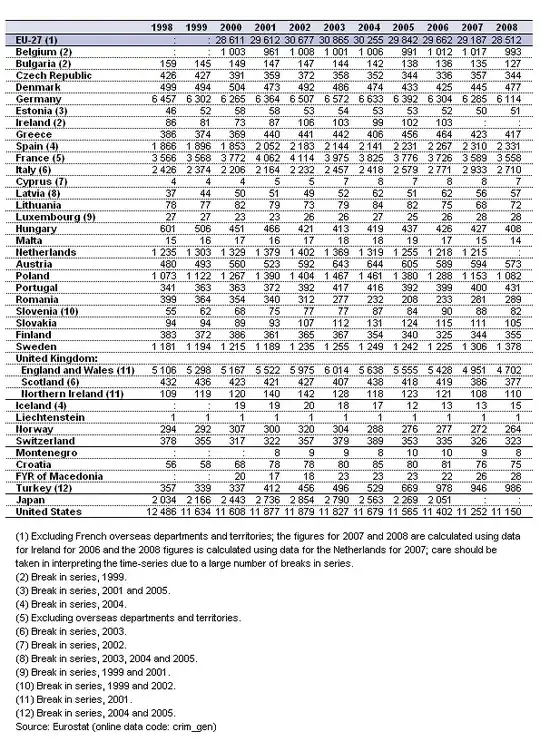

In Europe, this issue is less debated and the clear winner is that the death penalty was not working and it was fundamentally unethical. There have been no surging crime rates when it was abolished and no significant calls to reinstate it.
Crime rate in Europe
Crimes recorded by the police, 1998–2008 (1,000) — Source: Eurostat
Offences recorded by the police, EU-27, 2005–2008 (2005=100) — Source: Eurostat
