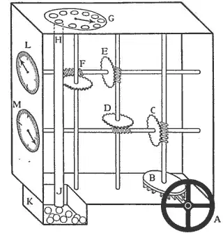

An odometer is a device used for indicating distance travelled by a vehicle. Vitruvius around 27 and 23 BC describes such a device and Hero also describes an odometer in chapter 34 of his Dioptra. Chariots with wheels of 4 feet diameter turns exactly 400 times in one Roman mile. For each revolution, a pin on the axle engage a 400 tooth cogwheel, thus making one complete revolution per mile. This engages another gear with holes along the circumference, where pebbles (calculus) are located, that drop one by one into a box. The number of miles travelled is given simply by counting the number of pebbles
Image from The Legacy of Rome, Clarendon Press 1923

    @jamesqf The claim itself recognizes that the taximeter was an odometer "Ancient Roman taxis had meters. A taxi in Ancient Rome had a crude mechanical odometer ". And concerning wheels, the quote in my answer says "Chariots with wheels of 4 feet diameter turns exactly 400 times in one Roman mile" and the drawing shows wheel "A". I don't understand what part of the claim you are still skeptical about. There is also an earlier (1923) Popular Science article. Added to my answer. – DavePhD May 23 '15 at 12:06
