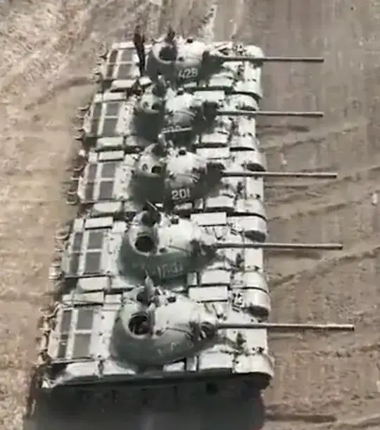

    The 2023 tank has been identified as a T-55A (see my answer), an upgrade of the T-54. One of the upgrades is NBC (Nuclear, Biological, Chemical) protection. That might require changing, for example, how things like the copula are bolted down to avoid leaks. The idea that one would upgrade the copula but not add reactive armor assumes the upgrades were done recently. However, the upgrade from T-54 to T-55A would have been done in the late 1960s long before ERA was popular. – Schwern Feb 11 '24 at 03:25

  1. The number on the side of Soviet tanks in 1956 did not have a consistent meaning. It varied unit by unit, but it was never a unique identifier for the tank and certainly not over 70 years. That these two tanks are of similar types and have the same tank number is likely a coincidence.
  2. Oryx has identified the 2023 tank as a damaged T-55A, while the Budapest tank is a T-54. However, the T-55A is a 1960s upgrade of the T-54.
  3. Over 60,000 T-54 variants were built and only 3 have been confirmed damaged or destroyed in Ukraine.
There's nothing which says they're not the same tank, but it's slim odds they are.

The tank in the 2023 photo has been identified by Oryx as a T-55A.
The T-55 was accepted into service in 1958, and the T-55A came even later; the tank in the 1954 picture certainly is not a T-55, but a T-54.
However, the T-55 is essentially an upgraded T-54. They're so close they often get lumped together as the T-54/55. According to Tank Encyclopedia Archives...
Many T-54s were indeed retro-fitted to the T-55 standard, which included full NBC protection, the new V-55 diesel rated for 581 hp, increased range and ammunition (T-54M and AMs).
The upgrade would have been done in the 1960s explaining the lack of modern features such as ERA (Explosive Reactive Armor). The T-54/55 continued to be upgraded; if it were upgraded later it would be an upgraded model. ERA was introduced in the 1990s with the T-55AMV.
Looking at museum photos of T-54M and T-54AM, T-54s upgraded to T-55 standards, we see they retain features not present on the 2023 tank. That would seem to rule out the 2023 tank being an upgraded T-54. However, these are museum pieces with a focus on preservation. We're talking about a tank that's been in Soviet/Russian service for almost 70 years and two governments. It's difficult to say what additional modifications have been done in that time, so I can't say this rules it out.
On the third hand, over 60,000 T-54 variants were made, and only 3 have been confirmed damaged or destroyed in Ukraine. That's long odds.
