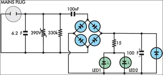

Maurio Grassi at Silicon Chip took one of these apart
(Electricity savings box circuit diagram)
As @William Beaty guessed, it's basically just a big capacitor to correct the power-factor; since you are not billed on your power-factor, this will save you absolutely no money.
"Power Factor" and devices that claim to save energy by fixing it explains and debunks these power-factor scams.

    Plus correcting the power factor requires you to actually know what you are trying to correct. If your load is inductive than adding capacitance will make power factor better but if not then adding capacitance will make power factor worse. – Peter Green Jan 11 '18 at 19:20
    Not that it affects the validity of the answer overall but I'd say when that schematic has been produced the mu characters have been dropped and the values should be 6.2μF and 100μF. A 6.2F mains rated capacitor would be huge and expensive. – PeterJ Jan 28 '18 at 02:42
  • @PeterGreen, most unbalanced loads are inductive: transformers in power supplies, coils in motors, etc. – Mark Jul 16 '20 at 03:21
    I'd imagine most of the PF issues in domestic properties nowadays would be harmonic currents from switchmode power supplies rather than the traditional inductive/capacitive issues. The remaining AC motors would likely be behind thermostats/timers/controls. – Peter Green Jul 16 '20 at 03:46
    This component values in this schematic make very little sense... Bad source. – Lundin Mar 24 '23 at 15:11
