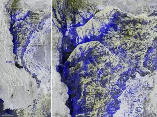

ESA repeats the claim but with attribution to the Pakistani minister. They don't endorse it themselves, and the blue area in their map is clearly more "zoomed in", note the 10-50 km scale and cities names, i.e. roughly centered around Larkana and the "triangle" flooded area.
Although it seems a lot of the claim repeats include NASA imagery, NASA themselves don't repeat the 1/3 claim. Also note compared to the other answer that what you see there (on "Live Science") is the zoomed in area boxed below...
