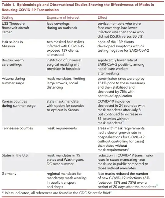

Regarding the bounty, which asks a somewhat broad question:
I still see comments in social media where people claim masks are ineffective. Has new data or research come out?
Yes. There's a Dec 18 meta-analysis of Covid-19 mask studies published over this year. Not surprisingly, masks were found to have worked for protecting healthcare workers from Covid-19 (5 case-control studies, all done in various countries in Asia).
For the healthcare workers group, masks were shown to have a reduced risk of infection by nearly 70%. Sensitivity analysis showed that the results were robust.
Results for mask wearing by the general public were inconclusive in that review; there was only one such study (in Thailand) included and it showed a trend but was not statistically significant. There is one additional study like that, (i.e. trend in the general public, but not statistically significant) in Denmark that was published perhaps too late to be included in that review (in this study giving a [free] pack of masks was the intervention). There's also a Dec-published study that does find an effect of masks when they were made mandatory in Jena (Germany) using as baseline a counterfactual model derived from the evolution of the infection in other German cities (which introduced no mask mandates at the time). Actually, in Nov this year, the CDC published a fairly similar study (in terms of design) on counties in Kansas. It turns out that there's (2021 publishing date) CellPress Med article summarizing such epidemiological evidence (too diverse to be the subject of a meta-analysis, it seems):
So, the reluctance of some public health officials to recommend mask wearing for the general public back in Feb or so, appears somewhat justified in that it's hard to design a study to show a definitive effect in the general public, given all the confounders ([other] social distancing rules introduced concomitantly, possible poor[er] adherence to mask protocols by the general public etc.) Keep in mind however that most of these studies used data from the Spring of 2020. Studies using the "Fall 20202 Covid wave" have basically yet to be published... It may be easier to show a (statistically significant) effect in the general public when there's greater (baseline) risk of infection, which the fall wave actually did provide in many countries...
