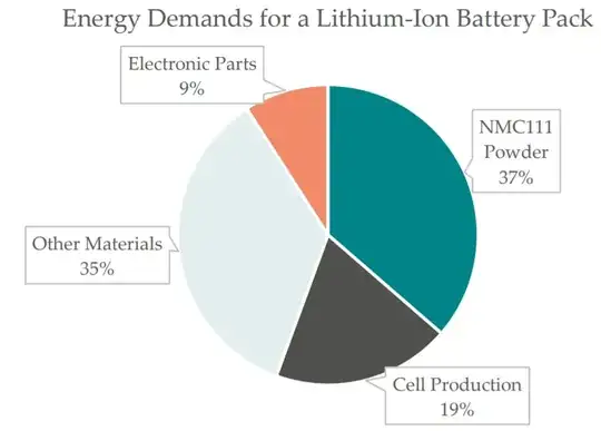

To what degrees each step from the manufacturing process contributes to the CO2 emissions associated with battery production, from the 2019 IVL study:1 Energy Demands for a Lithium-Ion Battery Pack: Electronic Parts 9%, NMC111 Powder 37%, Cell Production 19%, Other Materials 35%
