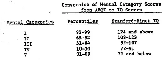

I am unable to find a good source for the correlation between ASVAB and IQ. This 37 year old military report suggests that a 91 IQ is equivalent to a 31 on the ASVAB, which means Peterson's claim is correct. However, this research is quite old, and tests and populations have changed in that time. I am going to refrain from giving a definite answer.

That the lowest 10th percentile of AFQT test takers cannot join is unrelated to IQ. But let's make up a thought experiment:
The lowest 10th percentile of IQ is described by the military itself as corresponding to an IQ of 72:
The 10th percentile IQ score for Cattell Culture Fair is 69.
So if AFQT were an IQ test,
or better thought of as:
"if the military would recruit people based on IQ testing and apply the same scaling and 10th percentile cut-off",
then the category IV would mean people with IQs of 69 or 72 or 81 would still be allowed to join on that IQ measure alone.
Another answer notes (which is also the source for the picture above)
but should be rewritten as
that Peterson's claim is incorrect.

Going back to "the law":
Translating from percentiles to 'IQ', the law implies that an IQ below 81 (“tenth percentile”) is disqualifying, and dictates that persons with IQ’s between 81 and 93 (“thirty-first percentile”) cannot comprise more than 20% of all enlistees.
–– (src, comparison)
For added redundancy:
We do not find such a pattern. Table 8.2 lists the ASVAB weights for the first principal component; these weights suggest that while AFQT is highly correlated with g (P = 0.829), it is a suboptimal measure of general intelligence, which suggests that H&M may underestimate the effect of intelligence on social outcomes.
Our results are consistent with the theory of general intelligence: our version of g explains a high proportion of the variance in test scores and g is remarkably similar across race and gender. However, our results conflict with the predictions of H&M. Ability factors other than g are economically useful. Compared with education, family background, and region of residence, g explains little of the variance in wages; if there exists some "X factor" that can explain the large residuals common in wage regressions, it is not measured cognitive ability. We also find that the returns to g differ significandy across race and gender; payment is not made for "ability" alone, which violates the definition of meritocracy advanced by H&M. In summary, our reanalyses of the NLSY data originally analyzed by H&M show measured cognitive ability is correlated with wages but explains little of the variance in wages across individuals and time. This finding is mirrored in Ecclesiastes 9:II:
… [f]he race is not to the swift, nor the battle to the strong, neither yet bread to the wise, nor yet riches to men of understanding, nor yet favor to men of skill; but time and chance happeneth to them all.
–– Cawley: "Cognitive Ability, Wages, and Meritocracy", in: Bernie Devlin et al (Eds): "Intelligence, Genes, and Success. Scientists Respond to The Bell Curve", Springer: New York, 1997. (Herrnstein and Murray use the Armed Forces Qualifying Test (AFQT), an equally weighted composite of four items of the ASVAB, as their measure of IQ. They show that the AFQT has the internal structure of an IQ test and that it correlates highly with traditional IQ tests. They further argue that it is one of the best measures of general intelligence or g currently available. (See, however, the chapter byJohn Cawley et al. in this volume, in which they argue that the AFQT is a flawed measure ofgeneral intelligence.))
At least the military says to Peterson:
Efforts are being made by military behavioral science research programs to develop additional screening instruments, including measures that supplement the predictive power of the high school diploma and AFQT score. Such endeavors might result in small gains to expand the recruitment pool and reduce attrition. Even with increased quotients of those who have graduated from high school and who had appropriate AFQT scores, first-term attrition remains more than 30%.
There is not an inexpensive screening tool with adequate predictive validity and reliability to identify individuals at high-risk of attrition before they enter military training and service. The best predictor of success in the military is still a high school diploma or 2 or more years of college. Robert Cardona & Elspeth Cameron Ritchie: "Psychological Screening Of Recruits Prior To Accession In The US Military" (PDF)
