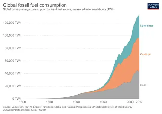

This chart is taken from https://ourworldindata.org/fossil-fuels ; most data there comes from the published paper:
Vaclav Smil (2017). Energy Transitions: Global and National Perspectives. & BP Statistical Review of World Energy..
It is coherent with figures from the World Bank: https://data.worldbank.org/indicator/EG.USE.COMM.FO.ZS ; https://data.worldbank.org/indicator/EG.USE.PCAP.KG.OE
fossil fuel consumption
The growth is indeed exponential or, arguably, linear since 1950 with a strong slope. The consumption reached 83,000 TWh in 1990, then 134,000 TWh in 2017.
Using data from the same source, the aggregated numbers confirm that 50% of total (1800-2017) consumption of fossil fuel has happened after 1990.
I basically summed the data in the online-available spreadsheet; I don't think that should be dismissed as "personal research" ?
edit: some comments debate whether fossil fuel consumption is the same as fossil fuel use (as per the OP). I cannot find easily whether the data here refers to the total primary energy of the fuel or to the energy produced after transformation - I strongly suspect it is the former, since it is much easier to compute (at any given time, there are several machines using coal, with different efficiency, so it is much easier to mesure the quantity of coal burned that the output). Moreover, the subtitle of the chart explicitely mentions primary energy. In case I am wrong, this chart should only be considered as a proxy for the question asked.

  • It's worth noting that total energy consumption follows a similar curve, owing to it being almost entirely provided by burning fossil fuels. – MooseBoys Aug 13 '19 at 02:53
    TWh are a rather odd unit for fuel consumption. That's a unit of energy produced. – Acccumulation Aug 13 '19 at 03:40
    @Acccumulation : that's an important distinction, because it is likely that engines and power plants became more efficient over time, so if we use TWh instead of tonnes, the amount of fuel being consumed will be overestimated. – vsz Aug 13 '19 at 04:00
    This is energy of the fuel, not extracted useful work. TWh is a commonly used number when discussing various fuels that don't have the same energy density - 1 ton of wood isn't the same as 1 ton of coal. – Zizy Archer Aug 13 '19 at 08:55
    "exponential or, arguably, linear" Make your mind up. Those are two completely different things. It's like describing somebody as "a serial killer or, arguably, petty thief." – David Richerby Aug 13 '19 at 10:59
    @DavidRicherby It says "exponential" or "linear since 1950". The curve could just as easily be fitted with either an exponential or with a piecewise linear function using two pieces, nothing to do with making up of the mind. – DonFusili Aug 13 '19 at 11:42
    @DavidRicherby We are not defining a precise mathematical function but describing a curve. Both an exponential or a piecewise linear model would have a good fit with the empirical available data. Maybe figures in 2050 will actually prove that both models were poor predictors. – Evargalo Aug 13 '19 at 11:48
    This answer, as it stands, is incorrect because as others have pointed out, it's measuring total energy production from fossil fuel sources, not the fuel used to produce said energy - the graph even states this! The answer should either be edited to reflect that it's an extrapolation based on available data for energy production, or deleted altogether. – Ian Kemp Aug 13 '19 at 12:18
    @IanKemp The graph shows the amount of fuel consumed in terms of TWh. There is a constant conversion factor from tonnes of fuel to TWh for each fuel type. It's not showing the downstream production of usable energy (which would require knowing the world's average energy efficiency), it's showing the energy content of the raw fuel that's been burned. This shows the fuel used to produce said energy, I don't see anything to indicate otherwise. – Nuclear Hoagie Aug 13 '19 at 12:45
    @IanKemp A single google search for the words "Primary Energy" (The words from the graph) explain your misunderstanding. – DonFusili Aug 13 '19 at 13:17
    @ZizyArcher yes, but if we've burned X tons of coal since 1900 and > (X/2) tons since 1990, Y therms of natural gas since 1900 and > (Y/2) therms since 1990, Z barrels of crude oil since 1900 and > (Z/2) barrels since 1990, that still means that over half the world's fossil fuel consumption has occurred since 1990. – Doktor J Aug 15 '19 at 21:27
