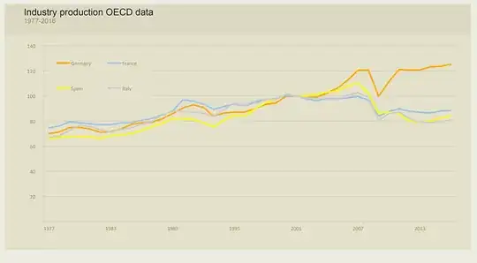

The data seems accurate. I re-calculated the OECD data to 2001 = 100 but didn't truncate the y-axis (truncating the y-axis overemphasizes any relative increase or decrease):
De-Fr-Es-It
I also created a second sheet by removing Spain and Italy and adding Switzerland (non-Euro/non-EU) with a similar development as Germany and the UK (non-Euro/EU) with a similar development as France:
De-Fr-CH-UK
If you want to create your own charts use two Excel sheets: one with the OECD industry production data of all OECD and some others countries downloaded from OECD.Stats and the "chart maker".
If you want to replace a country in the chart maker, change the country name and copy the respective column of the country in the OECD industry production data sheet to one of the columns on the left (e.g. replacing Italy). The chart as well as the re-indexed data on the right will be changed automatically.
If you want to choose another base year, choose one year on the right and set it to 100. You have to modify the functions of all other years manually though (takes two minutes).

  • Upvoted for not truncating the zero. That always makes shifts seem more dramatic, and is a known way to bias change into something that seems more dramatic. – Edwin Buck Mar 23 '17 at 17:01
