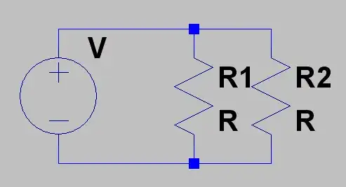

Next, consider the effect of parallel resistors:
The resistance of a parallel combination of resistors is
             1            R1 * R2
R_net = _-----------  =  ---------
          1       1       R1 + R2
         R1       R2
The net current through the entire system (that which will trip the circuit breaker) is I = V / R_net. This current is divided through both resistors based on the ratio of their resistances so that Ohm's Law remains satisfied; the potential V = I * R must be the same for both resistors.
