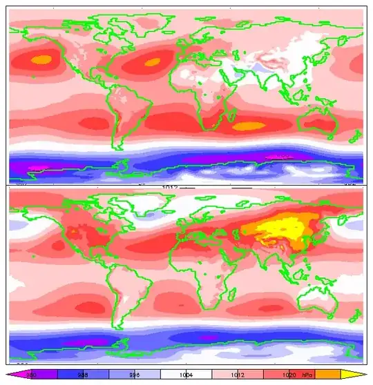

  • The pressure isn't normally exactly 1atm.
    pressure distribution
    In the picture, 1atm pressure is light pink
