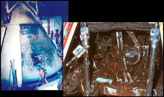

As to breathing pure oxygen, it does not get you "high" in any way. Consider that oxygen masks are deployed when the pressure is low, you actually need more oxygen to actually get into your blood stream. NASA would employ a trick of using less atmospheric pressure in their capsules, and having the astronauts breathe pure oxygen. That practice was mostly stopped after the Apollo 1 Accident.
Apollo 1 Fire
