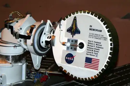

Mars Rover from nasa.gov New Curiosity Mars Rover from nasa.gov Memorial to Columbia, placed on Mars Rover
