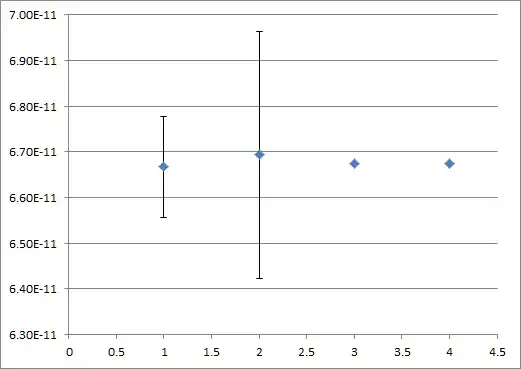

Here are 4 different values for G from different sources:
When plotted in a graph with error bars, we have the following:
Graph of Gravitational Constant Measurements
So measurements are not constantly done, the "official" value is not updated regularly, and the results of the measurements are published.

  • Egads, man! Don't connect the damn dots on a plot like that. The line means less than nothing. – dmckee --- ex-moderator kitten May 29 '13 at 20:52
  • Indeed, "connect the dots" is near enough to always wrong that you should just not do it, full stop. – dmckee --- ex-moderator kitten May 29 '13 at 21:01
