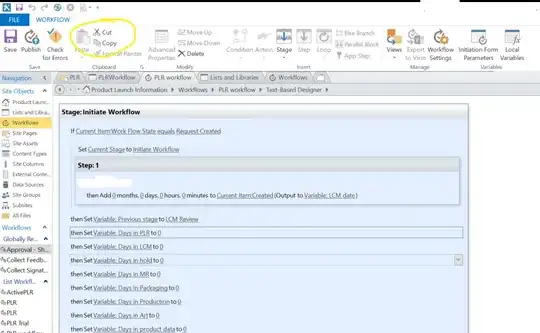

I had the exact same problem but found a very easy solution. Open SharePoint designer - select your entire workflow (Select all) > Copy > And paste the content inside a new workflow(create an empty workflow before hand). Boom !!!! Done enter image description here Worked like a charm - I am not facing any issues. My workflow was very complex and long so reconstruction would have been a nightmare.
Hopefully this helped someone out there !
