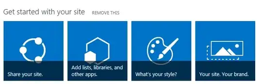

Hello,
I create an app using the Promoted Links in Sharepoint 2013. I chose to do this because the feature has the awesome hover effect and is easy to customize the image.
The issue is that I have been trying to figure out how to change the tile sizes. They are awesome the way they are, however I just need them smaller. I still want the hover effect as well and for the text to match the same ratio as the tile. I have tried web zones, I have done each ID but with no luck. I have attached a sample image of the tiles I'm referring to. Please help.

  • Thats what I thought too, but no luck. Theres are the classes and IDs that I used:
    code/ .ms-tileview-title-root{ Width: 50px; Height: 50px; }
    .ms-tileview-tile-content{ Width: 50px; Height: 50px; }
    .ms-tileview-tile-content img{ Width: 50px; Height: 50px; }
    .ms-tileview-tile-deailsBox{ width:50px; height:50px; }
    .ms-promlink-body{ width:50px; height:50px;
    #promotedlinksbody_WPQ8{ width:50px; height:50px; }/code
    – Question-Everything Jan 06 '14 at 18:01
  • I can't give you a complete solution but you are on the right track with this. Keep going and you'll get there. Unfortunately SharePoint's CSS is notoriously difficult to work with. When you do come to a solution make sure to test the hell out it with different browsers. – Derek Gusoff Jan 06 '14 at 18:16
    perfect its working fine after including this code in CSS file. But, image size in not reducing according to the tile size. It should decrease actually. What to write there to decrease the image size same as the tile size. Thanks.. –  Mar 06 '14 at 13:37
23
For a CSS-only approach, add the following CSS inside a Content Editor web part or add it to your custom CSS. Remove the <style> tag as necessary.

The code is for a tile size of 100x100. For your own images, the above code should do the trick. For the OOTB SharePoint images (the images that you get with the default tile set ("Share your site", "Working on a deadline?", etc.)), you'll have to make further changes.

    THANK YOU SO MUCH! This did it! In relation to my own images I added code/ .ms-tileview-tile-content img{width:100px!important; height:100px!important;} /code Other than that, it works! I didn't bother with the positioning of the sprite images (because I'm confidient we won't be using them, but you never know) but will look into them much later. Again, thank you! – Question-Everything Jan 06 '14 at 20:05
