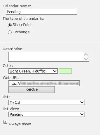

Instead of using JavaScript to color code which you can find code for doing here I'd recommend that you use the standard Overlay capabilities of SharePoint calendars.
  1. Create three additional views Pending, Progress and Resolved which only show items in the appropriate status.
  2. Change the default view to only show Status = "None".
  3. In the "Calendar Tools|Calendar" ribbon tab click "Calendars Overlay"
  4. For each of the three stati
    1. Click New Calendar
    2. Fill in information like this
      1. Calendar Name: Pending
      2. Type: SharePoint
      3. Color: Light Green
      4. Web URL: Leave alone
      5. Click Resolve
      6. Select right Calendar as List
      7. Select right View as List View
      8. Always Show: Checked
