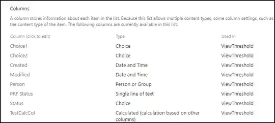

This should help you to find both display names and internal names:
How to find display name of list columns?
You can find/see the display name of list columns in list view itself. If you want to check the display names of all list columns, navigate to List settings page.
You can see the display name of all list columns under Columns section on list settings page:
Here you can see the display name of column under Column (click to edit) section.
