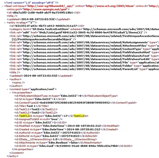

Now to check the field details you just add some dummy element in the List and check the details of the fields using the following REST API URL:
http://SITEURL/_vti_bin/client.svc/web/lists/getByTitle('TestList')/items
Now you will get following data in IE: enter image description here
Now check the above picture carefully, the userid needs to be saved in the TestCL3Id column not in the TestCL3. This is the reason of the error. Now check the following code:

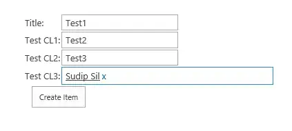

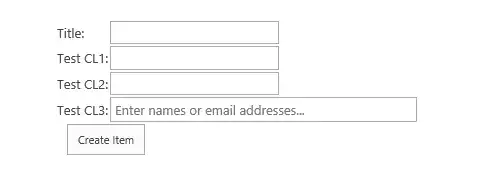

This will create the following UI: enter image description here
- Add some data in the fields. You can see the Test CL3 field is getting autopopulated. enter image description here
- Click Create Item - The Item should be created.
