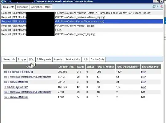

We have an new sharepoint 2013 site, Server Virtual and standalone , it has 12 gb ram. This sharepoint user interface extremely slow.
In Developer Dashboard we see each aspx page requests waiting about 6-7 second.
Aspx request waiting
sql execute details in aspx request
Have any idea ?

  • on developer dashboard tumbnail.aspx waiting about 7000 ms, you can see call stack below; enter image description here enter image description here SqlCommand: 'proc_FetchDocForHttpGet' CommandType: StoredProcedure CommandTimeout: 0 Parameter: '@RETURN_VALUE' Type: Int Size: 0 Direction: ReturnValue Value: '' Parameter: '@DocSiteId' Type: UniqueIdentifier Size: 0 Direction: Input Value: '1e581f6c-2a2d-4df3-bb27-6425f6ae152f' Parameter: '@DocDirName' Type: NVarChar Size: 4000 Direction: Input Value: 'DivanHotel/PR2' P – Sefer K Apr 12 '13 at 13:42
  • Obviously your SQL communication is slow, There might very well be some bad configuration in SQL Server. How much memory is your SQL server instance using (in Task Manager)? And how much CPU? – Robert Lindgren Apr 12 '13 at 13:55
  • using only 450 mb – Sefer K Apr 12 '13 at 13:56
  • sory you asked cpu: cpu using only between 0-2 – Sefer K Apr 12 '13 at 13:59

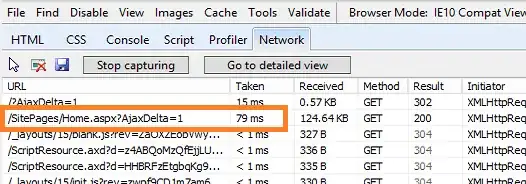

My problem solved!
Have a follow this link.
Turn off distributed cache:
Site loading time with it off:
site loading time with it on:
!!! From 6.10 seconds down to 79 ms

  • In performance monitor ram usage is only 5-6 gb. There are not content on db, only empty sharepoint template. – Sefer K Apr 12 '13 at 11:15
  • @SeferKILIÇ you need to enable DD to monitor then – Muhammad Raja Apr 12 '13 at 11:42
  • I see in DD , all aspx request waiting about 6000 ms, – Sefer K Apr 12 '13 at 13:12
  • On sql tab i saw sql request/response details and I think there is a sql server problem here .
    proc_FetchDocForHttpGet 3.525 ms DECLARE @DocPare 2.690 ms proc_GetTpWebMetaDataAndListMetaData 2.388 ms proc_GetWebMetainfo 1.747 ms
    – Sefer K Apr 12 '13 at 13:14
