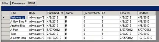

Edit:
After running the query in U2U my results have been validated. See the images below.
The CAML Query using <Today/>: The CAML Query using Today
The results from the query using <Today/> (note the date stamps go back months): The results using Today, note the date stamps
The results of the query after changing <Today/> to <Now/>: The results using Now - none returned
There are no results returned using <Now/>... I'm trying to filter blog posts based on the PublishedDate. The time stamp needs to be included in this comparison, requiring me to use <Now/>.
