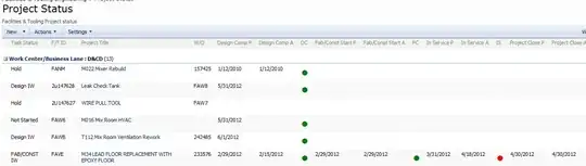

    I removed an If statement and added the If([Project Status P]="", ""white" and removed a ) in the middle of the nest and addit to the end. So @Ryan I was missing a ), Thanks! Here is the final formula and I attached a picture just in case someone wanted to see. ="
    "enter image description here
    – Trisha May 15 '12 at 19:42
