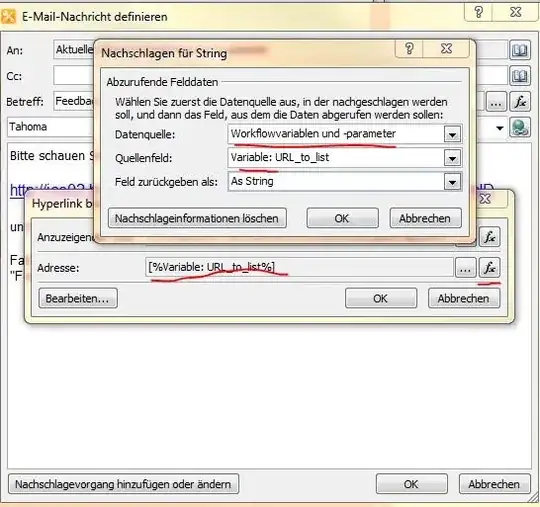

Following solution worked for me.
  1. First create a variable called URL-Item in SharePoint Designer. That variable should hold:
    a) link to your sharePoint list Instead of this format:
    http://br.com/Mordor/HR/Lists/Schulungsantrag/AllItems.aspx
    use this one
    http://br.com/Mordor/HR/Lists/Schulungsantrag/DispForm.aspx?ID=
    b) and next to it (in the same row) Current Item: ID
  2. Create Send an email action and in the email body part create a link based on the variable created earlier (s. the figure below). enter image description here

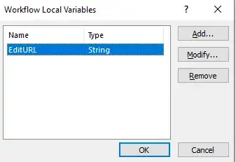

The following works with the following criteria
  • You are using the default forms, URL unmodified
  • You are using Workflow Manager services with SharePoint 2013 workflows
Steps
  1. Open your workflow
  2. Create a local variable as a string (EditURL as String) Edit URL
  3. Create a Replace Substring in String action
  4. Format the action to replace "DispForm.aspx" with "EditForm.aspx" from "Workflow Context: Current Item URL" assigned to the "EditURL" workflow variable. Substring action replacing DispForm with EditForm
  5. The EditURL workflow variable now contains your edit form URL.
