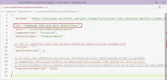

The first step is to get the extension's unique component ID, which is a GUID. You can get this from SPFx extension manifest file.
