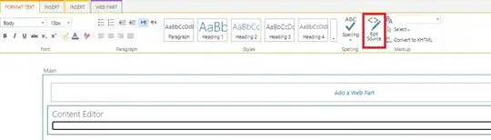

1.Edit page -> Add a content editor web part.
2.Press F12, find column ID. enter image description here
3.Edit page -> Edit source -> Add following codes.
Note: You should replace "ms-vb-lastCell.ms-cellstyle.ms-vb2.ms-vb-lastCell" with ID found in previous step. enter image description here
