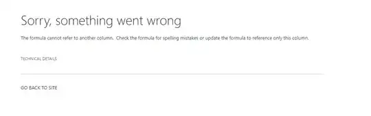

    Thanks teylyn and @hartraft. The formula is fine but it seems it is the limitation of SP that we cannot refer to another column inside another column for caculation as I am reciving the below error:"Sorry, something went wrong, The formula cannot refer to another column. Check the formula for spelling mistakes or update the formula to reference only this column.", so if this is the limitation, then nothing can be done as hartraft has pointed out, however, I have upvoted Teylyn and accepted Hartraft as the answer and really appreciate your support and thoughtfulness. – Mohsen Sichani Nov 04 '20 at 05:37
For Column Validation errors are being thrown most likely due to the fact that referencing multiple columns in Column Validation is not allowed.
Instead if you go to List Settings > Validation Settings you can set a formula to validate the Item in the List which allows referencing multiple columns.
