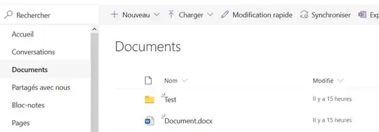

I've created some test folders&Docs on my created test site: enter image description here

  • Well even with this https://<>.sharepoint.com/sites/Contentieux/_api/web/GetFolderByServerRelativeUrl('/sites/Contentieux/Documents')/Folders this gives "d": { "results": [] }, tried '/sites/Contentieux/Shared Documents' also, maybe a problem with my auth token, but it would not say http 200 status :\ – bodtx Feb 14 '20 at 11:01
  • You need to pass the URL of document library and not the display name. that's why I added "Shared Documents" as this is the URL name of default document library (Documents) comes with SharePoint site. Can you please share the complete code with us? – Ganesh Sanap - MVP Feb 14 '20 at 11:04
  • ok thx for help, the root url contains french translatation of shared documents: https://<>.sharepoint.com/sites/Contentieux/_api/web/GetFolderByServerRelativeUrl('/sites/Contentieux/Documents partages')/Files – bodtx Feb 14 '20 at 11:31

  • Well even with this https://<>.sharepoint.com/sites/Contentieux/_api/web/GetFolderByServerRelativeUrl('/sites/Contentieux/Documents')/Folders this gives "d": { "results": [] } – bodtx Feb 14 '20 at 11:00
  • When you browse to that library in your web browser, check the URL in your address bar. To confirm the path of your library. It is likely different than the displayed Title. – willman Feb 14 '20 at 11:20
  • wooooouu, thx you bring me to the right place with url displayed on the bottom of the screen once inside an document. the trick is that the URL is in french, thought everything would be in english: https://<>.sharepoint.com/sites/Contentieux/_api/web/GetFolderByServerRelativeUrl('/sites/Contentieux/Documents partages')/Files – bodtx Feb 14 '20 at 11:30
