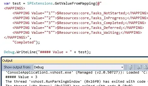

The testing result:
So, as you could have noticed from the screenshot, "Completed" display value was successfully resolved to "3".
